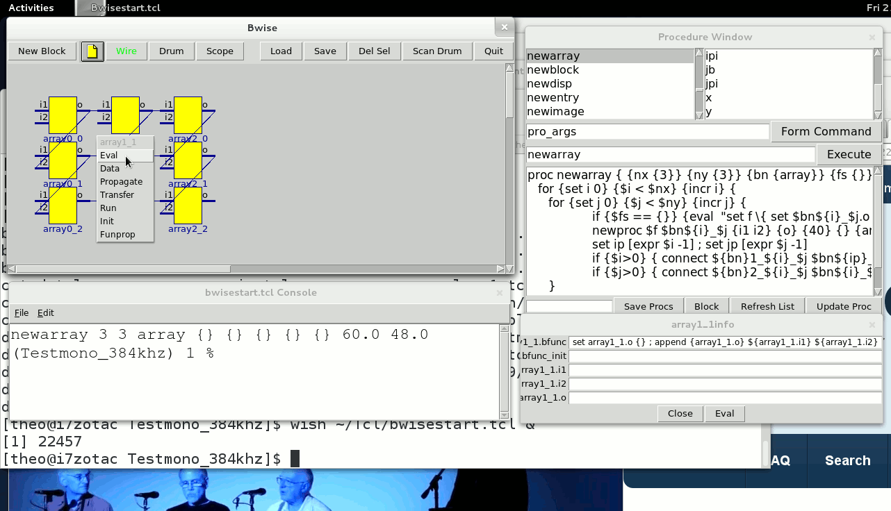

Ok, a little example for you guys, this is from my F.O.S. "Bwise" package, known for at least a decade and a half already, running on Tcl/Tk, as also runs on the standard Parallella distribution (maybe Tk needs to get installed with apt-get, I forgot):
So here we have an automatically generated array of processing blocks, with connection between them running from left side of a block (output) to right side of another block (input). Starting "funprop" from the popup menu on the left top blocl, will execute the blocks in such an order that the data is available at the inputs before the function associated with a block gets called, and the result of that function gets set at the output.
