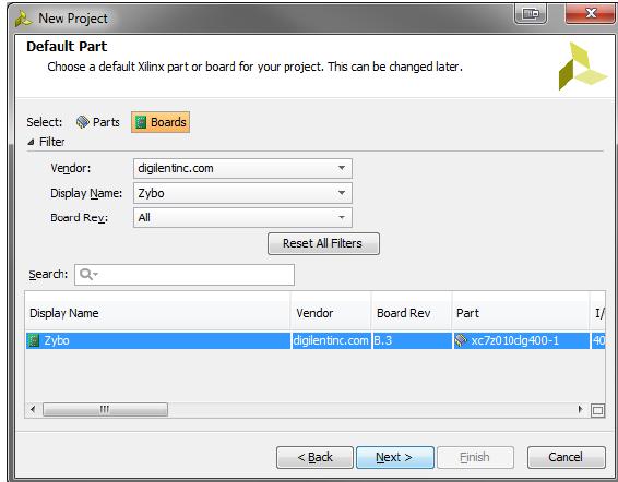

Is there any board file for parallella (like zedboard, zybo or ...) to use for configuration of Vivado at the start of creating a project (when choosing the development board)?
I mean add Parallella board to this dialogue:

That's just an FPGA chip chooser. Pick one of the "boards" and adjust accordingly. Main reason I can think of for it not having a "board" file is because they're not Digilent or Avnet. Xilinx works with them quite tightly- and none of this gets into the reality that you're not going to have a "board" file for a design you make in the first place. You're going to pick a rough board or the FPGA chip you know is on your device. You're not going to get a board file for anything other than an Arty on Artix setups, for example...
