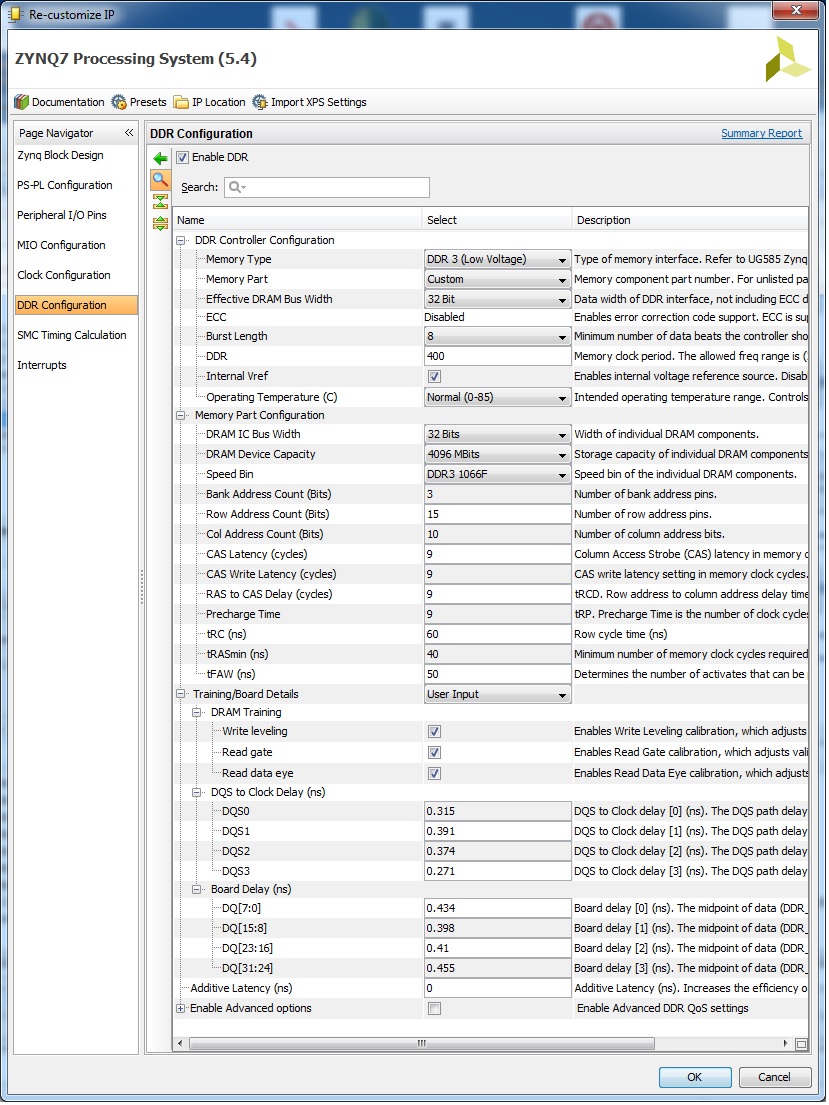

If you mean making your own standalone PL/PS design, yes no problems because that's something I'm doing probably 40 or 50 times a day (with HS2).
QSPI is fine and for DDR you need to setup PL as below:

Yes I do mean making my standalone PL/PS design. So with digilent HS2 I just connect it to the JTAG module, I don't have to connect the HS2 to the QSPI? I don't mind it being albeit slow so QSPI would be fine, but just to be sure if I save it on the QSPI I could use the design without a computer.
