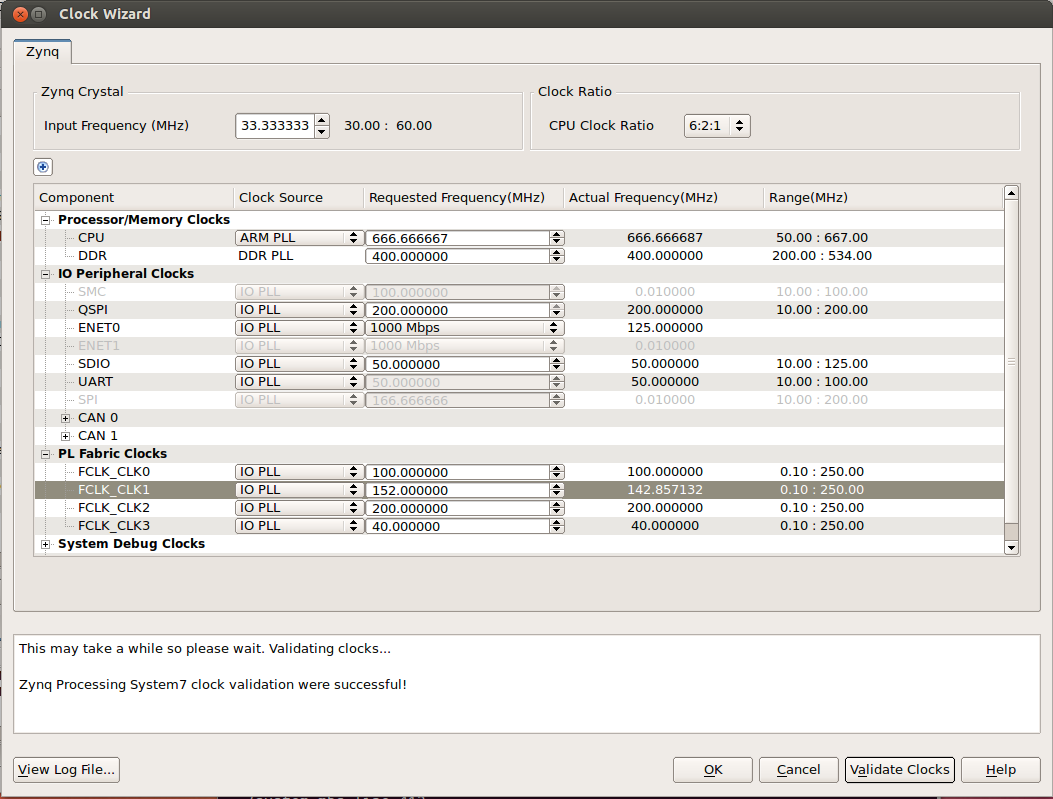

ESI makes a good point about the locale settiing, I remember that thread but can't find it now. However I think that would make a much larger error, if I change from 33.333333MHz to 33MHz in XPS it causes a much larger change than you're seeing. Strangely, I can't get either of the values from your error message. If I open the XPS project from the repo that frequency is reported as 142.857132, trimming one '3' off the input frequency changes it to 142.857117, below the numbers in question are 142.857136 and 142.857152. Here is a capture of the clock settings from XPS when I open the project straight from the git repo:
XPS clock settings for HDMI project.
If you open xps (either directly or by double-clicking on the system_i module in planAhead's project manager, then click on the "clock generation" block in the diagram, do you get the same values I show? If you then click on "Verify clocks" is it OK? Maybe this will help.
One more semi-random thing I can think of, if you go to the "Bus Interfaces" tab in XPS, what is the version number reported for the clock generator? I have 4.03.a, which is pre-production, but I don't see any updates available for it.
