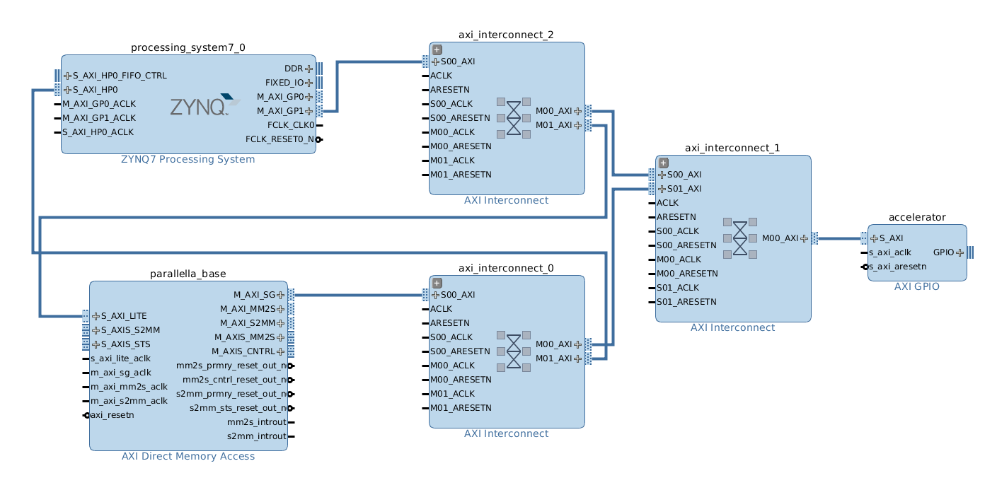

Ok enough with the digression. So I'm trying to understand the accelerator demo. I want to do something similar. See if I can implement an AXI slave that accelerates something like SHA256 hashing. What I cannot seem to understand is why the simple accelerator has instantiations (is that the correct term?) of modules that do conversion from eMesh to "packet" and vice versa? Once again, I've just been perusing the HDL and source, and I could be way off. Is it because the DMA controller is also implemented by Adapteva, and is it because the memory management module requires the the messages to be in "eMesh" format to determine if they get routed to DRAM or the Epiphany co-processor? If so then what exactly does AXI provide when you've layered your own protocol on top of it?

So I plan to have the eCores do SHA256 hashes. The accelerator will be used by the host program. So I hope that goes smooth. Why would the eCores not be able to communicate with the accelerator? The accelerator example in Oh! seems to use eLink since there is an instantiation of e2p for elink to packets and p2e for packets to elink. The accelerator example uses some mapped memory, so I don't see why the eCores could not use e_write or e_read to manipulate that memory or does e-lib's API restrict the calls to cores on mesh.

It depends on whether the eLink/AXI interface can communicate to the AXI master (Zynq PS) only, or if it can talk to an AXI slave (your accelerator). Just having an address doesn't mean that you can communicate. Just keep in mind that it might not work, or might require additional tricks.
Also, you need to get the addressing right, otherwise the Epiphany chip will route requests to the wrong port.
