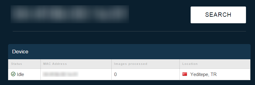

Postby yildizabdullah » Wed May 27, 2015 10:20 am
Now it's up and running:
