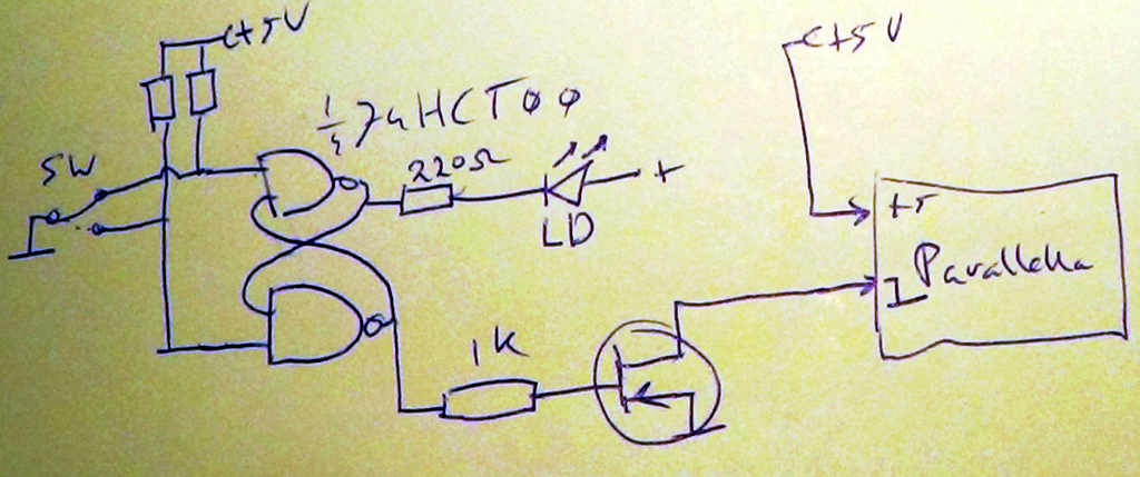

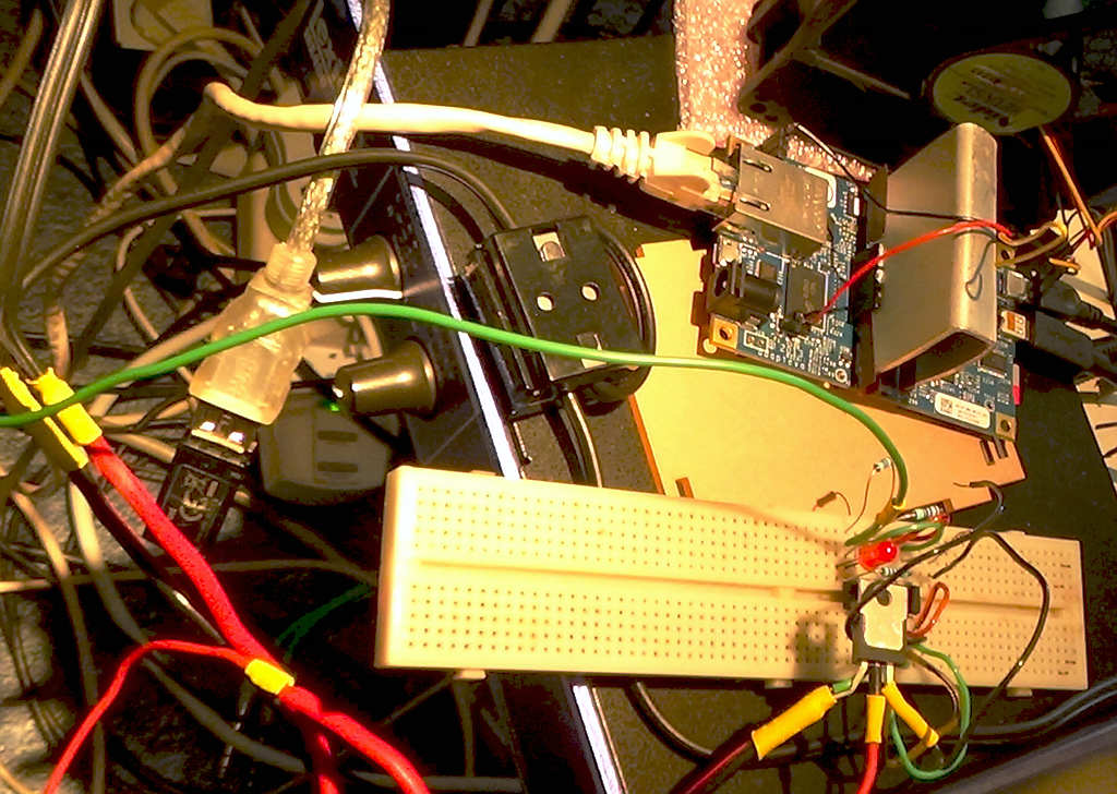

To check this out a bit, I decided to take the supplied supply unit, put a FET (a BUZ102SL) in between to switch it on and off with, and made a debounced signal to put the FET in on and off mode nearly instantly.
I used a 74HCT00 to make a bi-stable circuit, tapped the +5 Volt from the wall wart to feed it, now I can easily switch the Parallella (a 7010 with connectors) on and off, knowing for sure the FET will supply voltage very fast (and only very little loss about 60mV), and completely de-bounced (no switch artifacts).
Works fine, and I might have a higher probability percentage of functioning USB on my Conrad hub, but: still sometimes the USB didn't start up.

So I tried if a de-bounced "off" of the board will remedy these occasional file system glitches. Just starting X up, login in, doing a few things, and then killing the power abruptly with the new circuit I made worked without visible error, tomorrow I'll try a few more times with a new "shutdown" to see if the voltage drop of pulling power supply out of the wall socket is the cause of the disk corruption problem.

In short most of the times I started with this circuit:
the USB worked, but not exactly every time :(.
