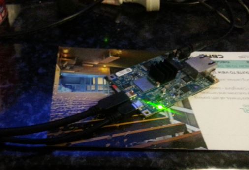

I just got my board (Parallella-16 with GPIO Zynq 7020, and I am having problems that there is nothing showing up on the screen. the only indication that I have is the LED on top of the inscription "A" on the "PARALLELLA" label. I used the Parallella Accessory Kit so for sure there would be no issue on the power supply

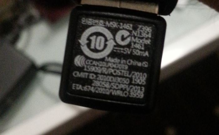

so what i did was plug-in Micro SD, HDMI to the TV (port J10) and I bought a Wireless Keyboard+Mouse (port J6), (http://www.microsoft.com/hardware/en-us ... yboard-800)
I dont have an Ethernet yet so nothing is plugged in, I dont have anything as well in J7. Placed the household Fan since i dont have the 5v DC fan yet. Turned the TV on and switched to HDMI.
Finally I plugged everything in, last is the power supply. then LED lighted green on the Power Adaptor, as well as the LED on top of "A". thats all..nothing happens, no booting.
how else can i check if the board is working? anything i missed? is there any basic video demo out there specific on unboxing?
Appreciate any help, thank you
Parallella plugged in but only showing green light
Only thing I added, Wireless USB of the mouse+keyboard
basic setup

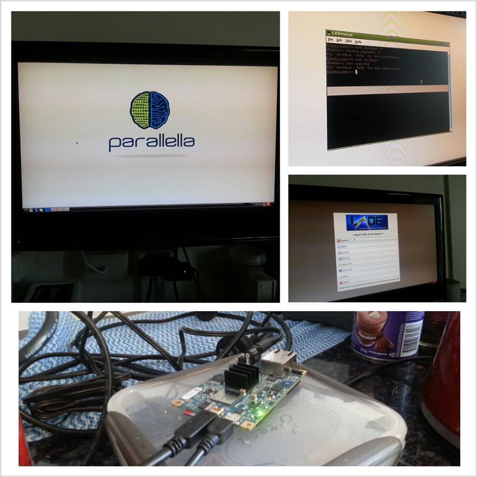

Cool, thanks.. its working now. I thought that the SD card has something in it already.
Thanks for the reply! cheers
Working with Mouse+Keyboard
