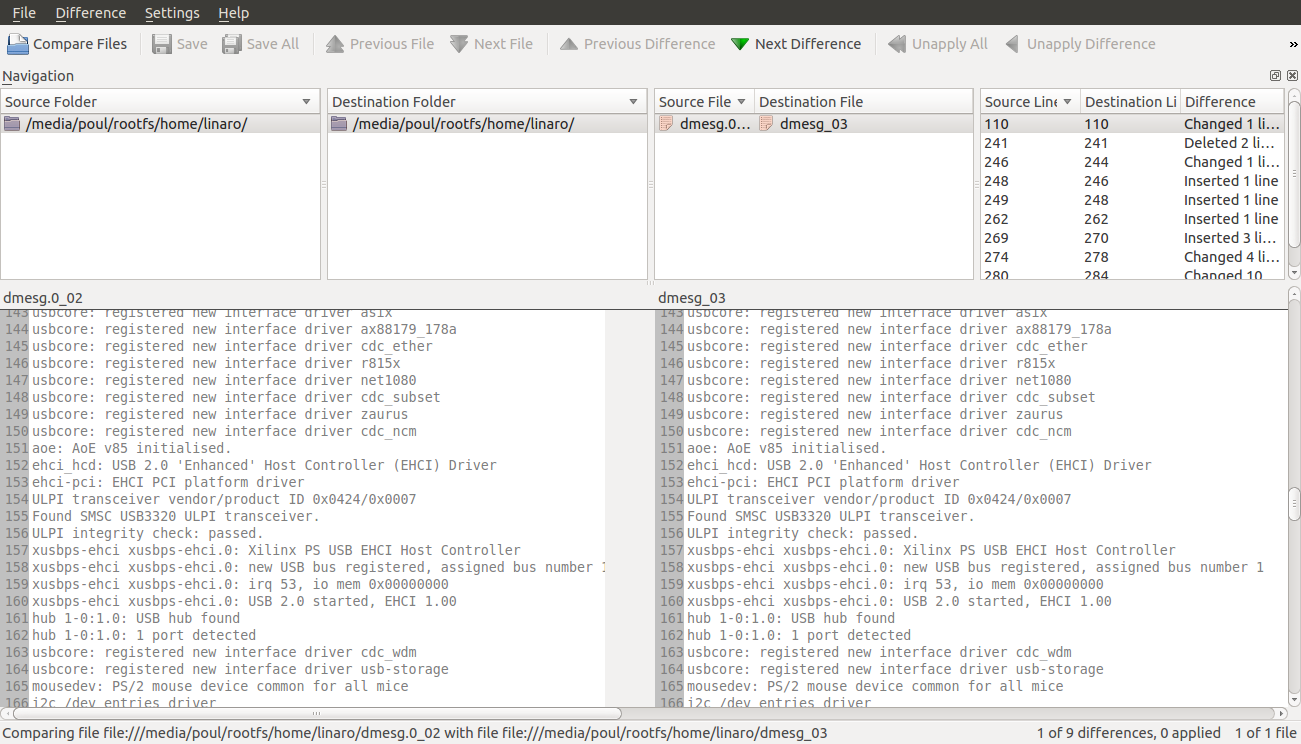

I have here two pic. The first shows when I power up and missing the USB, and after reset it finds the USB.
The second shows the result after I placed the jumper. Both powered up, and after reset it shows that USB is there.
Both studies started by first putting power on and wait for the login screen, then press the reset.
Look at line 154.

Thanks Frida, that's exactly what I see with some boards I have, just swapped from the way you have them (my pre-reset is your post-reset and v.v.).
If you are happy using your board with your mod then that's great, you've only given up the use of that LED for other purposes. If you don't want to give up the LED then you're welcome to apply for an RMA and you'll get a board that at least boots properly on power-up, though perhaps not on reset. Same goes for perles, Sean S and anyone else.
