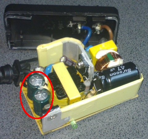

I had exactly the same issue as svidgen. The PSU is exactly the same, from the Parallella Accessories Kit. After disassembling the PSU, the issue was clear: the two filter capacitors had bulged top and bottom.
PSU
The bulged capacitors:
Capacitors bulged top
Capacitors bulged bottom
Replacing those two 1000uF 16V capacitors solved the issue. The Parallella board works well with it.
It is very weird that a brand new PSU has bulged capacitors. Capacitors usually do not bulge just sitting on a shelf. I have serious doubt about the manufacturing and testing process of this PSU. :-) Fortunately it is easy to fix.

Wow, this is amazing!! I can't tell you how much I appreciate you going through this process. I am still shocked that this happened with supplies that we bought in volume from a first rate electronics distributor!
Anyone having the "blinking green LED" problem should send a note to support@adapteva.com so that we can send you a new PSU.

I can confirm with bszente. I opened up mine also and those 2 capacitors are also bulging. Gonna order some caps to replace them.
