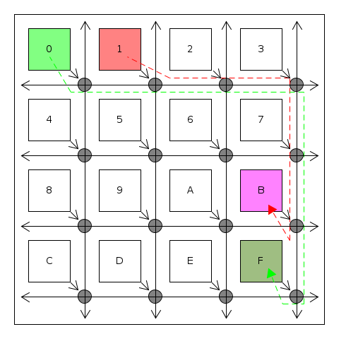

Ok. I figured out what I was doing wrong.
If I have only one core that creates extra traffic then it does not matter to how many other cores he will send data because due to Errata 1 the DMA engine can only output 1 DMA double word every other clock cycle. Hence the NoC will have plenty of time.
In my program I introduce different cores in between so for example: sending from core 1 data to core B, from core 2 to core 7 and core 3 to core B. Then I get a expected decrease in the bandwidth.
Thanks again for the help!
