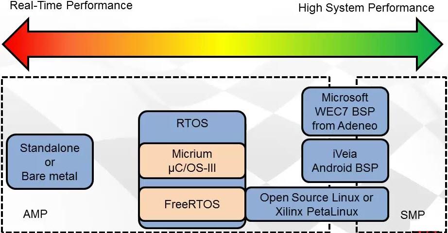

Postby zodane » Fri Dec 04, 2015 4:59 pm
Thank you for feedback Sebraa.
I want a full communication between the 2 ARM cores , epiphany and PL.
I want to be able to debug software and hardware.
And finally i don't need an operating system (bare metal application).
