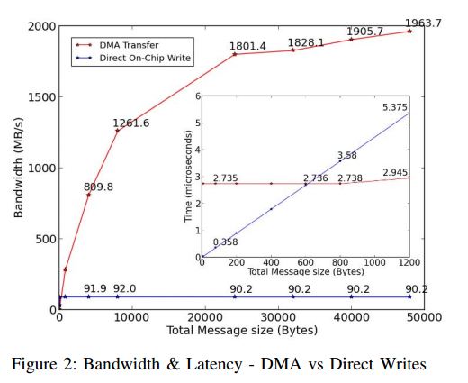

As I read page 22 of epiphany_arch_ref.pdf file, it says about cMesh:
"The cMesh network connects a mesh node to all four of its neighbors and has a maximum bidirectional
throughput of 8 bytes/cycle in each of the four routing directions. At an operating frequency of 1GHz, the cMesh network has a total throughput of more than 0.5 Terabit/sec."
but in paper titled "Programming the Adapteva Epiphany 64-core Network-on-chip Coprocessor " published in 2014 the following diagram is presented:
based on this report for message size below 50 byte the bandwidth is less than 90MB/s.
I want to know is there any way to make it more efficient, because I have an algorithm that need high communication rate between cores in 8 stage.
thanks
