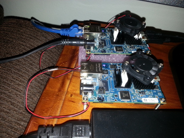

I complied xtemp.c and its running at 49 - 52 range 49 [is color blue text] and 52 [is red text]... does the 52 mean its maximum temperature recorded? i dont think it doesnt necessarily mean that I am over the recommended temperature ? or does it?
can I run this setup 24x7? 24 hours 7 days a week?
see below photo for my setup.
Parrallella boards
thank you! I appreciate the feedback!
