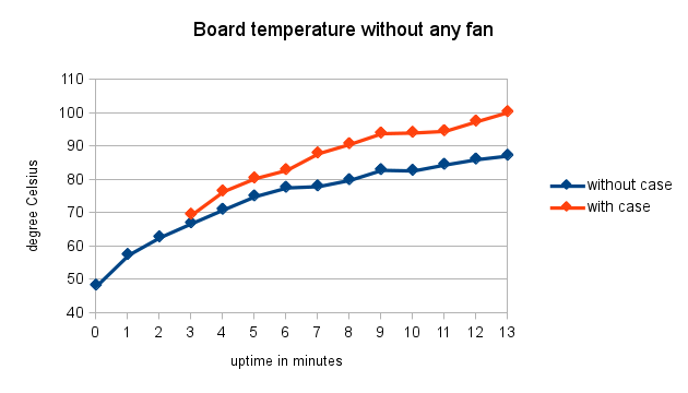

Postby bszente » Wed May 28, 2014 7:40 am
Temperature chart

Postby greytery » Wed May 28, 2014 9:42 am
Thanks for confirmation, bszente. It sounded too horrific.
You are right to be worried - far too hot - get that fan!!
I wonder : have you fixed the heatsink to the Zynq correctly?
