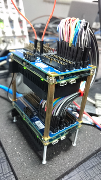

Your comments helped me a lot to test interboard communication, I have replicated your work and have read coreid's from south board on north board.
Next step will be handling interrupts from OS.
Because I could not wait delivery of connectors and cables to interconnect porcupines, I tried connecting them with jumper cables. For good surprise it worked, even with 300Mhz.

Wow, that is very cool!! An impressive number of wires.

I did that wiring while waiting for needed sockets and cables :).
