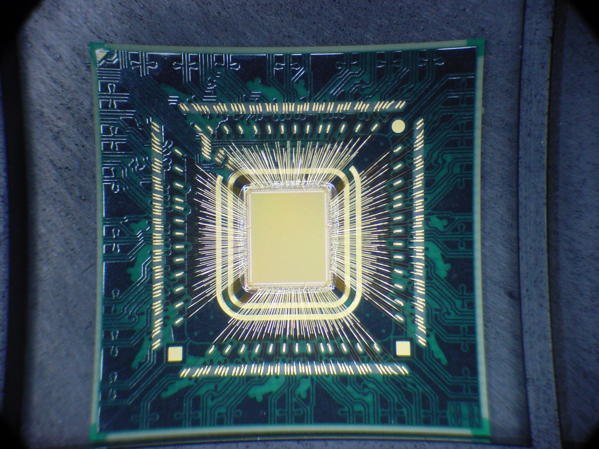

Getting nice high res pictures is actually a bit of a challenge. We use nine metal layers on our chip, with the top layer being dedicated to supplies. Unless we etch away the toplayer, the picture will just look like a boring plate of metal and not at all like the fancy die shots you would generally see from BigCo. We could go ahead and spend some money/time to get it done, but that will have to wait. In the meantime, here is a picture of our 16-core wirebond package (with the die in the middle).

Thanks for the picture, looks pretty :) What size is the die ? like 2x2 mm ?

wrt to the metalization layers, yes, I hadn't thought of that. Or maybe the fab itself takes pictures as part of some sort optical inspection or during the first runs ? In anycase, I agree that it's not really a high priority item :P
