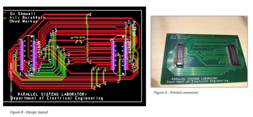

Have a look at this post, I've explained my eLink cluster project starting from BillOfMaterial and links where to find all the items.
All according to an experience that was documented years ago using 2014 ParaUbuntu Image.
You could help me trying to port the cluster to last ParaUbuntu image 2017.11 .... will you?
Well, about cables you have two alternatives:
1 - purchase the Parallella eLink cables here already done (18 Pounds plus shipment)
2 - purchase >40 flat cable (of 1mm, not standard 1.27mm) and the 40 pin female plugs. It's easy to press the flat cable to grip the contacts
Let me know about your progress, keep us in touch!

without a Porcupine (http://www.digikey.com @ 35$), you need this DIY...
