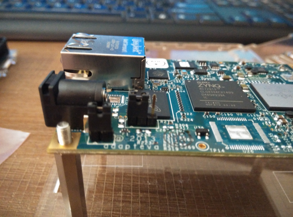

Postby Timtator » Mon Aug 03, 2015 9:36 am
So my dad is way smarter than me and suggested adding two pins and a jumper shunt so that I could easily remove one board from my cluster and switch it back to using the default power supply.
If the board came with 2 pins in J15, would mean someone simply just has to add the jumped shunt (or remove it so it could just come with the board) to enable the alternate power route.
It would probably be a bit harder with the 1601 board because there is a Samtec connector underneath the J15, but for the 1600 it works great.
Again the main purpose would be to stop people having to solder their board and risk voiding the warranty.
