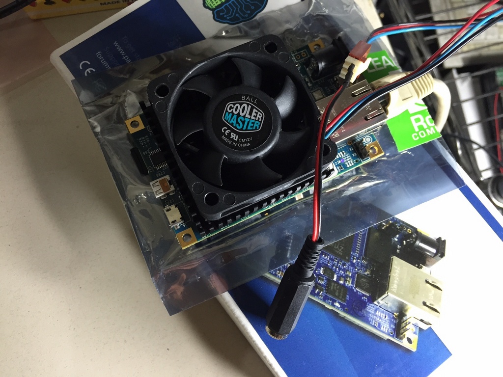

Using some spare parts from old pc and notebooks i found this cheap solution:

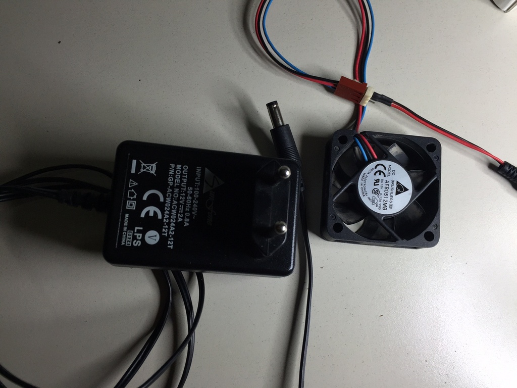

required:
12V Adapter (like from old notebooks or you can buy one)
12v fan (used old cooler master pc fan)
jack plug for the 12v adapter ( or some soldering skills :P)

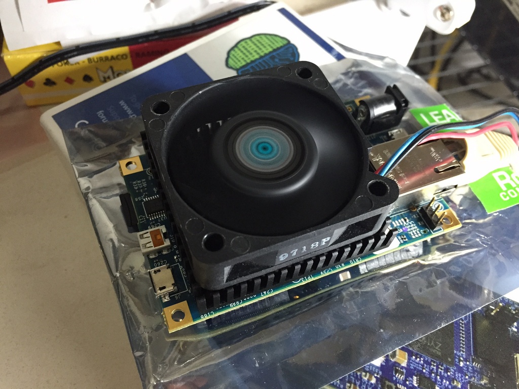

the working result is like that:

maybe its not the best solution but works fine.
( for some comparison of temperatures i wrote some on this post viewtopic.php?f=23&t=930&start=20)
the working temperature dropped a lot, so now i feel confortable to start testing the board with some project!
