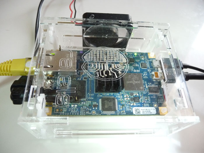

I have simply mounted it outside the case using super-glue (my home tool-box was over in my lab for the long-weekend), and so-far just covered the appertures each side with clear tape.
The 12V fan mounted on the case.
This is a 12V fan, and I am currently powering it from an old external USB drive supply. However it seems to run fine on 5V, almost silently, and after the weekend I will borrow a digital temperature monitor from my lab, and check the heatsink temperature running off 5V. If that is OK I will wire it into the case as per the 5V designs.

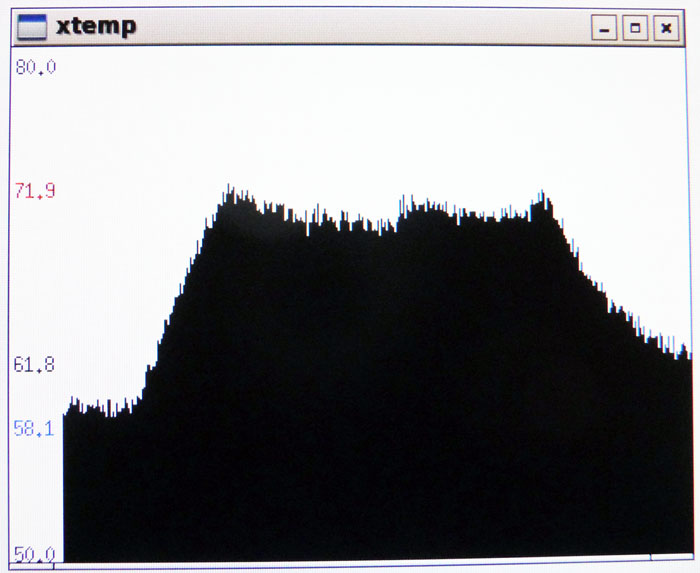

Ah, of course, the FPGA has an on-chip temperature sensor. And in the Parallella example program directory there is an already compiled temperature grapher program : xtemp.
I ran this, first with 12V applied to the fan : ~59C
then with the fan stopped : the temperature rows rapidly to over 70C and was still going up rapidly,
then with 5V applied to the fan : the temperature stabilised around 69C,
and then with 12V applied again, when the temperature again dropped.
This is when basically idelling - a few windows open and xtemp running.
Temperature graph : xtemp.
So the question is, is about 70C OK, running from 5V ?
Or should I go back to 12V ? I might see if a bigger heatsink helps.

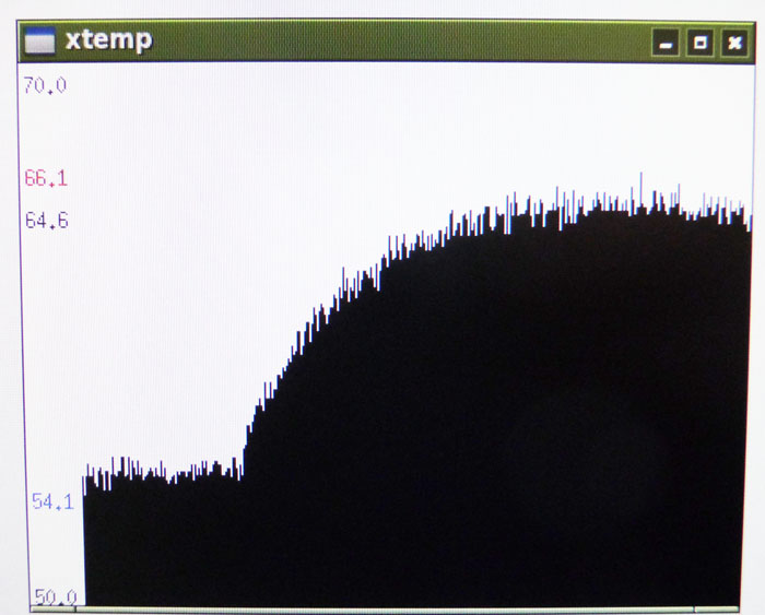

Running them both off 12V gives a temperature of about 55C.
Running them both off 5V gives a temperature of about 65C. which is I think fine.
See the temperature graph using xtemp :
Graph of temperature, initially 12V, then 5V.

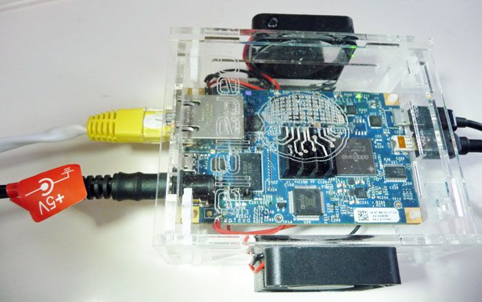

So connecting the fan leads to the 5V jumper and an earthed mounting hole, the system looks like as follows
- and runs whisper quite off the 5V :
Standard Adapteva case with 2x 12V fans running off 5V.
